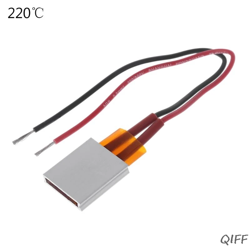

I’m planning to build a similar device (for my bees in the Netherlands…). Now I used an empty super with a net inbetween. Then I used a small candle to vaporise the oxalic acid inside the super. Its of course debatable if that is better than under them but thats not the point here.
But the candle handling is a bit too messy for my case so I wanted to go electric with this:
and use some 3S Lipos I still have from the RC plane and an ATTiny to control it (yes, a NE555 would do the trick but its actual fewer components with the Tiny and I don’t mind the programming).
I’ve ordered the parts and will post here if there’s interest.
